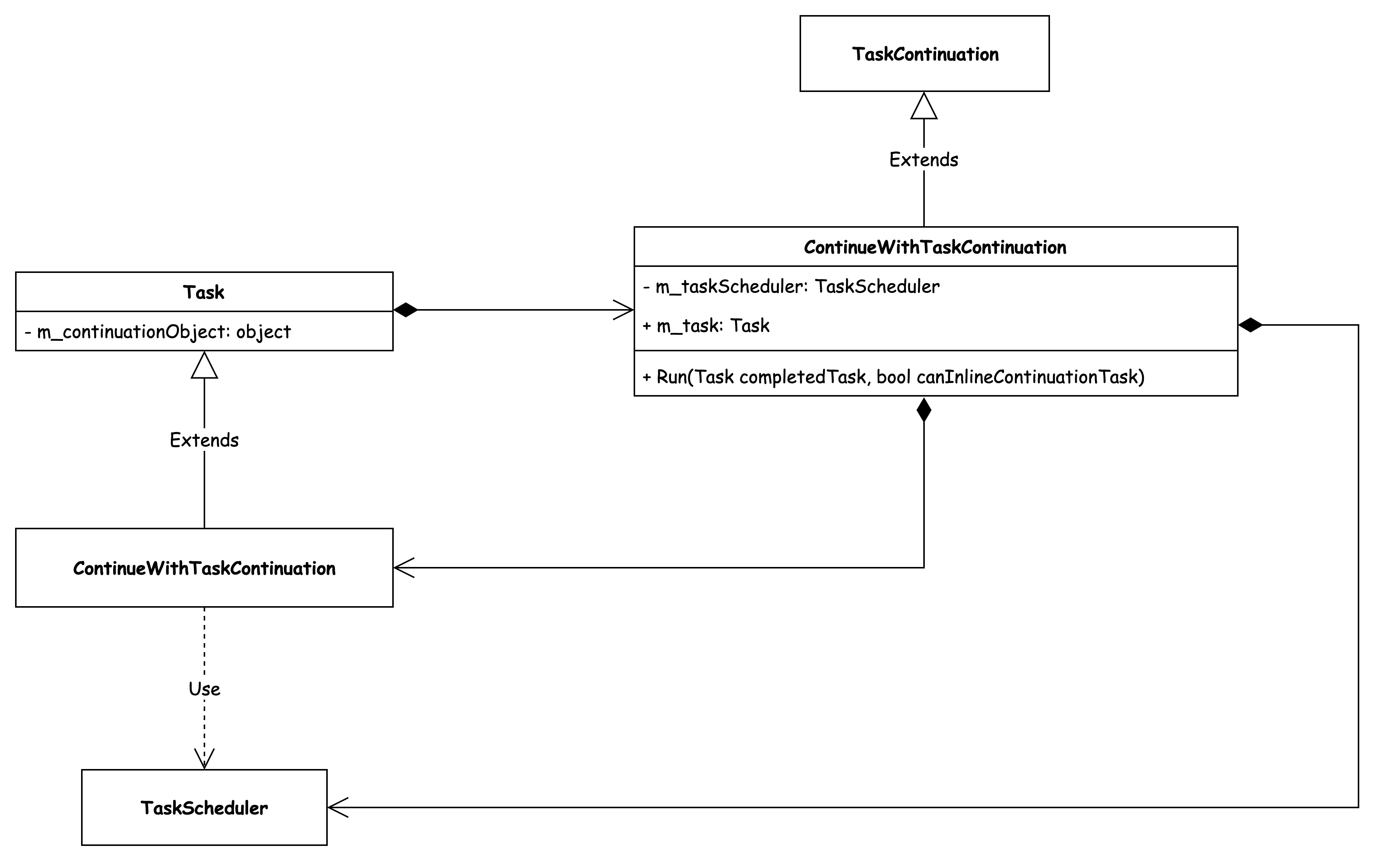

回调的容器:TaskContinuation
我们注意到 m_continuationObject 字段的类型是 object,而 object 类型在数据的存储上有更多的灵活性。
class Task
    // 保存一个或一组回调
    private volatile object m_continuationObject;
我们看下下面的代码
var antecedentTask = Task.Run(() =>
    Thread.Sleep(1000);
    Console.WriteLine("Antecedent Task Completed");
PrintContinuationObjectType(antecedentTask);
antecedentTask.ContinueWith(_ => Console.WriteLine("Continuation Task1 Completed"));
antecedentTask.ContinueWith(_ => Console.WriteLine("Continuation Task2 Completed"));
Console.ReadLine();
void PrintContinuationObjectType(Task task)
    var continuationObject = typeof(Task)
        .GetField("m_continuationObject",
            BindingFlags.NonPublic | BindingFlags.Instance)
        .GetValue(task);
    var type = continuationObject?.GetType().FullName ?? "null";
    if (continuationObject is IEnumerable enumerable)
        type += $", Element type: {enumerable.Cast<object>().First().GetType().FullName}";
    Console.WriteLine(type);
执行结果如下
null
System.Threading.Tasks.ContinueWithTaskContinuation
System.Collections.Generic.List`1[[System.Object, System.Private.CoreLib, >Version=6.0.0.0, Culture=neutral, PublicKeyToken=7cec85d7bea7798e]], Element type: >System.Threading.Tasks.ContinueWithTaskContinuation
随着回调函数注册数量的增加,m_continuationObject 保存的数据类型也在变化
  1. 没有注册时:null
  2. 一个回调时:ContinueWithTaskContinuation 实例
  3. 超过一个回调时:元素类型是 ContinueWithTaskContinuation 的 List<object>

ContinueWithTaskContinuation 的父类 TaskContinuation 是一个抽象类。除了 ContinueWithTaskContinuation,还有别的实现。
internal abstract class TaskContinuation
    internal abstract void Run(Task completedTask, bool canInlineContinuationTask);
ContinueWithTaskContinuation 维护着 Task 执行相关的两个核心对象,一个是 Task 本身,另一是 TaskScheduler。真正执行回调之前,需要先调用 TaskContinuation.Run。
internal sealed class ContinueWithTaskContinuation : TaskContinuation
    internal Task? m_task;
    internal readonly TaskContinuationOptions m_options;
    private readonly TaskScheduler m_taskScheduler;
    internal ContinueWithTaskContinuation(Task task, TaskContinuationOptions options, TaskScheduler scheduler)
        m_task = task;
        m_options = options;
        m_taskScheduler = scheduler;
    internal override void Run(Task completedTask, bool canInlineContinuationTask)

回调执行真正的决定者:ContinueWithTaskContinuation
在 ContinueWithTaskContinuation 中维护着待执行的 ContinuationTask 以及决定 ContinuationTask 最终执行方式的 TaskContinuationOptions 和 TaskScheduler。
        m_task = task;
        Task? continuationTask = m_task;
        m_task = null;

所谓的 Inline 是指在触发回调的线程中直接执行回调。
像 Task.Run 创建的 Task(由 ThreadPoolTaskScheduler 调度,也就是由线程池调度) 的回调如果是 Inline 执行的话,那执行回调的线程和执行传给 Task.Run 的委托的线程,就会是同一个线程池线程。因为线程池在执行完委托之后,就会触发回调执行。
我们注册的 TaskScheduler 可以选择是否只是 Inline。

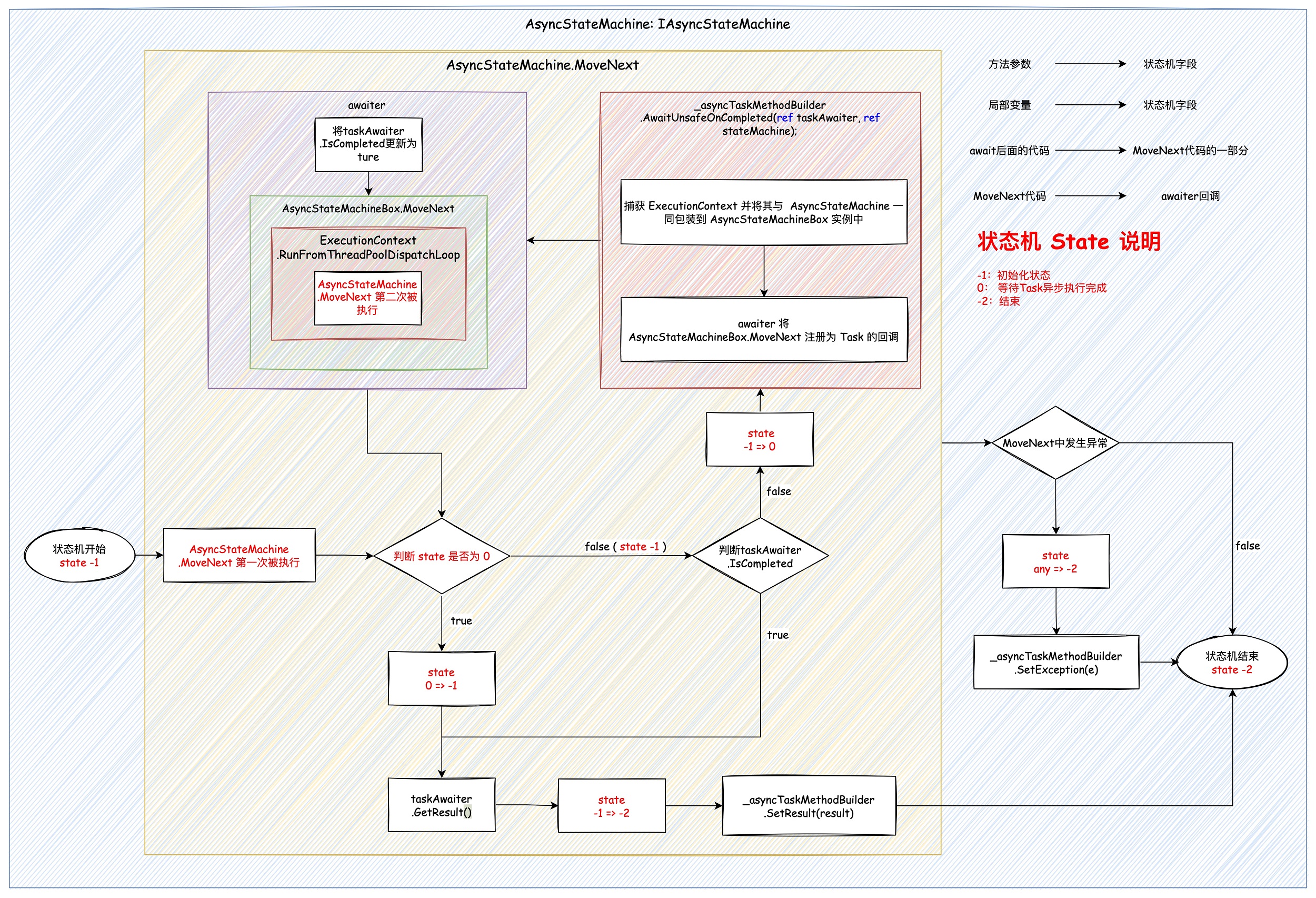

        task.SetContinuationForAwait(continuation, continueOnCapturedContext, flowExecutionContext);
可以看到 TaskAwaiter.OnCompleted 就是往 Task 注册回调,而 await 关键词的本质就是把 await 后面的代码变成了回调并注册到了 Task 上。

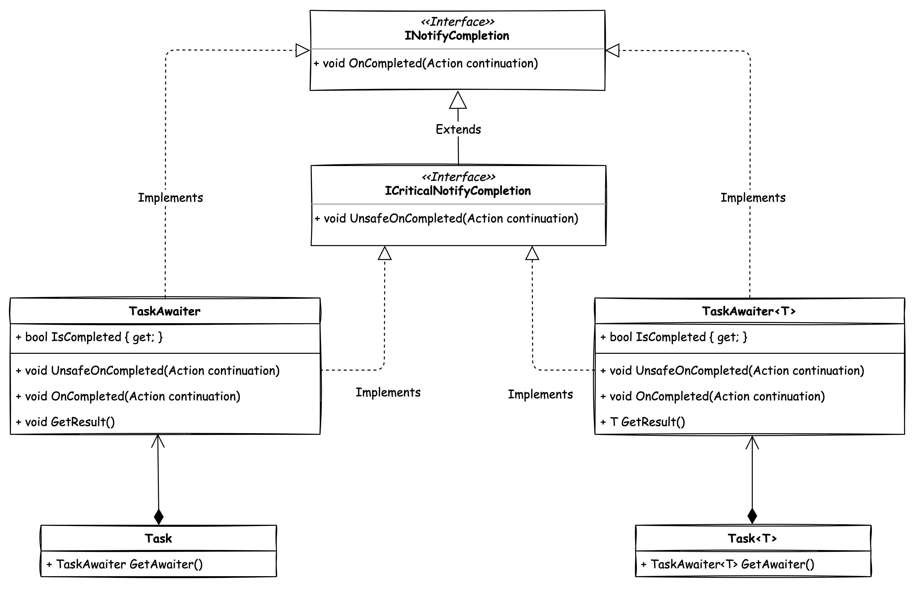

await Anything
C# 编译器并没有限制 await 关键词只能用在 Task 上。例如 Task.Yield() 的返回值 YieldAwaitable,既不是 Task 也不是 Task 的子类。
public readonly struct YieldAwaitable
    public YieldAwaitable.YieldAwaiter GetAwaiter() => new YieldAwaitable.YieldAwaiter();
    public readonly struct YieldAwaiter :
        ICriticalNotifyCompletion,
        INotifyCompletion
        public bool IsCompleted => false;
        public void OnCompleted(Action continuation) => YieldAwaitable.YieldAwaiter.QueueContinuation(continuation, true);
        public void UnsafeOnCompleted(Action continuation) => YieldAwaitable.YieldAwaiter.QueueContinuation(continuation, false);
        public void GetResult()
Task 和 YieldAwaitable 都提供了一个 GetAwaiter 方法。
返回的 XXXAwaiter 需满足以下两个条件:
  1. ICriticalNotifyCompletion,INotifyCompletion 这两个接口。而 ICriticalNotifyCompletion 是 INotifyCompletion 的子接口。
public interface INotifyCompletion
    void OnCompleted(Action continuation);
public interface ICriticalNotifyCompletion : INotifyCompletion
    void UnsafeOnCompleted(Action continuation);
  1. 提供 IsCompleted 属性 和 void GetResult() / TResult GetResult() 方法。GetResult 方法是否有返回值取决于 await XXXAwaitable 是否想提供返回值。
实际上,我们自己想要实现一个 Awaitable 的话,Awaiter 只需要实现 INotifyCompletion 接口或者 ICriticalNotifyCompletion 就可以了。

一旦实现了 ICriticalNotifyCompletion(INotifyCompletion 的子接口),注册回调走的是 UnsafeOnCompleted 方法。如果同时实现两个方法,也还是以ICriticalNotifyCompletion 的规则优先。
INotifyCompletion VS ICriticalNotifyCompletion
既然实现 Awaitable 只要实现两个接口之一,那为什么要区分出这两个接口呢。
我们来看看 TaskAwaiter 里的实现是什么样。

OnCompleted 和 UnsafeOnCompleted 的唯一区别是在调用 TaskAwaiter.OnCompletedInternal 时,flowExecutionContext 这个参数有所不同。
ExecutionContext 的本质是一个线程私有变量,维护着我们常用 AsyncLocal 的数据,例如 Thread.CurrentThread.CurrentCulture 其实就是一个 AsyncLocal 变量。
runtime 中会在发生线程切换的地方,将 ExecutionContext 从前一个线程拷贝到后一个线程。那么第二个线程里也就可以拿到在第一个线程里设置好的 AsyncLocal 变量。
就算线程没有发生切换,runtime 里有的地方也会通过清空 ExecutionContext 来阻止其往后传播。

由 FooAsync 编译成的 IL 代码经整理后的等效 C# 代码如下:
using System;
using System.Runtime.CompilerServices;
using System.Threading.Tasks;
class Program
    static async Task Main(string[] args)
        var a = 1;
        Console.WriteLine(await FooAsync(a));
    static Task<int> FooAsync(int a)
        var stateMachine = new FooStateMachine
            _asyncTaskMethodBuilder = AsyncTaskMethodBuilder<int>.Create(),
            _state = -1, // 初始化状态
            _a = a // 将实参拷贝到状态机字段
        // 开始执行状态机
        stateMachine._asyncTaskMethodBuilder.Start(ref stateMachine);
        return stateMachine._asyncTaskMethodBuilder.Task;
    static async Task<int> BarAsync()
        await Task.Delay(100);
        return 3;
    public class FooStateMachine : IAsyncStateMachine
        // 方法的参数和局部变量被编译会字段
        public int _a;
        public AsyncTaskMethodBuilder<int> _asyncTaskMethodBuilder;
        private int _b;
        private int _c;
        // -1: 初始化状态
        // 0: 等到 Task 执行完成
        // -2: 状态机执行完成
        public int _state;
        private TaskAwaiter<int> _taskAwaiter;
        public void MoveNext()
            var result = 0;
            TaskAwaiter<int> taskAwaiter;
            try
                // 状态不是0,代表 Task 未完成
                if (_state != 0)
                    // 初始化局部变量
                    _b = 2;
                    taskAwaiter = Program.BarAsync().GetAwaiter();
                    if (!taskAwaiter.IsCompleted)
                        // state: -1 => 0,异步等待 Task 完成
                        _state = 0;
                        _taskAwaiter = taskAwaiter;
                        var stateMachine = this;
                        // 内部会调用 将 stateMachine.MoveNext 注册为 Task 的回调
                        _asyncTaskMethodBuilder.AwaitUnsafeOnCompleted(ref taskAwaiter, ref stateMachine);
                        return;
                else
                    taskAwaiter = _taskAwaiter;
                    // TaskAwaiter 是个结构体,这边相当于是个清空 _taskAwaiter 字段的操作
                    _taskAwaiter = new TaskAwaiter<int>();
                    // state: 0 => -1,状态机恢复到初始化状态
                    _state = -1;
                _c = taskAwaiter.GetResult();
                result = _a + _b + _c;
            catch (Exception e)
                // state: any => -2,状态机执行完成
                _state = -2;
                _asyncTaskMethodBuilder.SetException(e);
                return;
            // state: -1 => -2,状态机执行完成
            _state = -2;
            // 将 result 设置为 FooAsync 方法的返回值
            _asyncTaskMethodBuilder.SetResult(result);
        public void SetStateMachine(IAsyncStateMachine stateMachine)
编译器在 Program 中创建了一个内部类,也就是 FooStateMachine 这个状态机,而 FooAsync 方法则变成了对这个状态机的使用。
AsyncTaskMethodBuilder 的作用解释放到下一篇文章再解释,这边简单理解成 AsyncTaskMethodBuilder.SetResult 就是 FooAsync return 返回值,AsyncTaskMethodBuilder.SetException 就是 FooAsync 内部往外扔异常。
完整的流程如下图所示:
一个方法中就算有个 await,这个方法也只会有一个对应的状态机。就.NET 6 SDK 的编译结果来看,state 会出现 -1 => 0(等待第一个Task异步执行完成) => -1 => 0(等待第二个Task异步执行完成)这样的流程。
