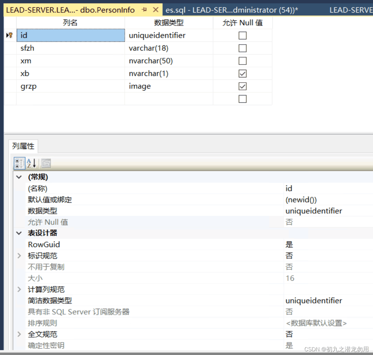

SqlServer数据表部分设计样本
设计 PersonInfo 数据表如下:
CREATE TABLE [dbo].[PersonInfo](
    [id] [uniqueidentifier] ROWGUIDCOL  NOT NULL,
    [sfzh] [varchar](18) NOT NULL,
    [xm] [nvarchar](50) NOT NULL,
    [xb] [nvarchar](1) NULL,
    [grzp] [image] NULL,
 CONSTRAINT [PK_PersonInfo] PRIMARY KEY CLUSTERED
    [id] ASC
)WITH (PAD_INDEX = OFF, STATISTICS_NORECOMPUTE = OFF, IGNORE_DUP_KEY = OFF, ALLOW_ROW_LOCKS = ON, ALLOW_PAGE_LOCKS = ON) ON [PRIMARY],
 CONSTRAINT [IX_PersonInfo] UNIQUE NONCLUSTERED
    [sfzh] ASC
) ON [PRIMARY] TEXTIMAGE_ON [PRIMARY]
GO
ALTER TABLE [dbo].[PersonInfo] ADD  CONSTRAINT [DF_PersonInfo_id]  DEFAULT (newid()) FOR [id]
GO
通过查询 select sfzh,xm,xb,grzp from PersonInfo where id=xxx 得到DataSet,再取 Tables[0]中的数据。

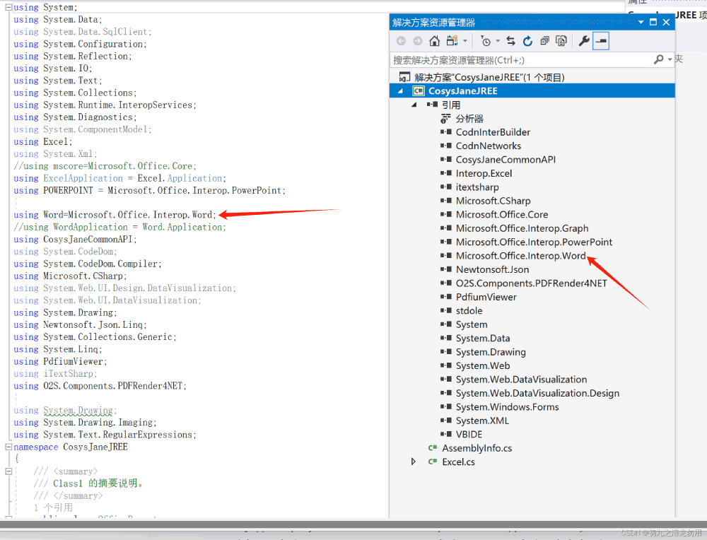

组件库引入
实现原理
