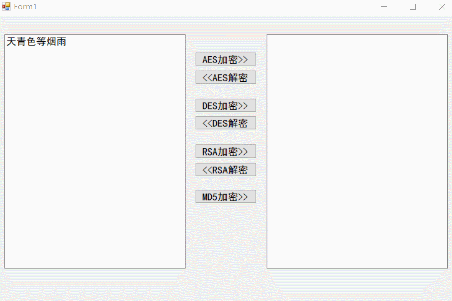

实现功能:
    • 使用AES加密方式加解密文本数据
开发环境:
开发工具:Visual Studio 2013
.NET Framework版本:4.5
实现代码:

    private void btn_Aes_Encrypt_Click(object sender, EventArgs e)        {          string result= AesUtil.Encrypt(textBox1.Text, "12345678900987654321");          textBox2.Text = result;        }
private void btn_Aes_Decrypt_Click(object sender, EventArgs e) { string result = AesUtil.Decrypt(textBox2.Text, "12345678900987654321"); textBox1.Text = result; }
实现效果:
